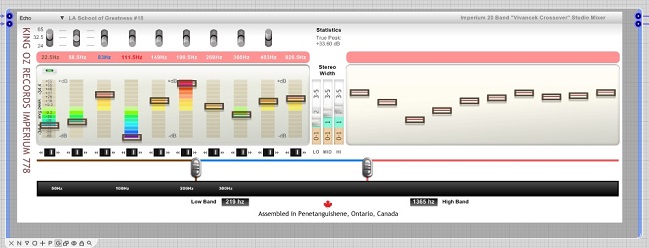

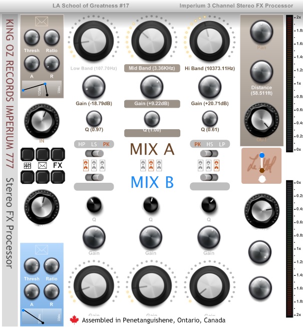

I recently used them in a new product I'm working on called the TQ:
TQ EQ (Thanks to Loopeytunes for Knobs):
The attachment tq resized.jpg is no longer available
Imperium 778 (20 Band Vicanek Crossover) Thanks to Loopeytunes and Nubeat for GUI Elements
Vivancek Crossover EQ
Imperium 777 Processor Thanks to Loopeytunes and Nubeat for GUI Elements:
imperium processor
imperium processor
imperium 777.jpg (122.85 KiB) Viewed 26242 times
