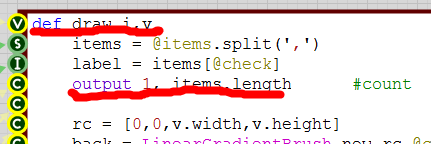

Re: RUBY: Droplist selector uses massive CPU when copied
This is what I'm referring to.
But the two lines above it also doesn't belong into a drawing method, since they create anarray from a string and evaluate one of the created values. That's all time consuming, when several redraws take place. The method is called "draw" for a reason ;)
Thank you SO much tulamide! :D
I do believe I actually understand this now :lol:
I’ve re-worked the RubyEdit and all seems well now, but maybe you or someone else could have a look to see if there’s anything else stupid remaining.
This has been a great learning experience for me so, again, thanks to all for joining in.
Ruby dropbox with very high cpu dev 5 .fsm
FIXED!!
(28.04 KiB) Downloaded 982 times
