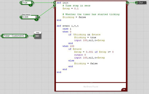

I have found that when I use the "Ticker - Custom" they do not tick when I initially strat the program, I have to go in and remove the "On" check mark and then replace it. Once I do that it works fine until I close the program and reopen it. Any thoughts?
- Ticker.JPG (49.2 KiB) Viewed 23624 times

dange11 wrote:removed and reinserted the check mark in the on box
That's a clue to the easy way - by doing this you are sending a trigger into the input, causing an event which sets the timer running.
So the simplest way to make sure it automatically starts ticking is to simply put an "After Load" (and "After Duplicate" possibly) connected to the same Ruby input as the on/off checkbox.
That will give it the 'kick' it needs to get running at load time.
