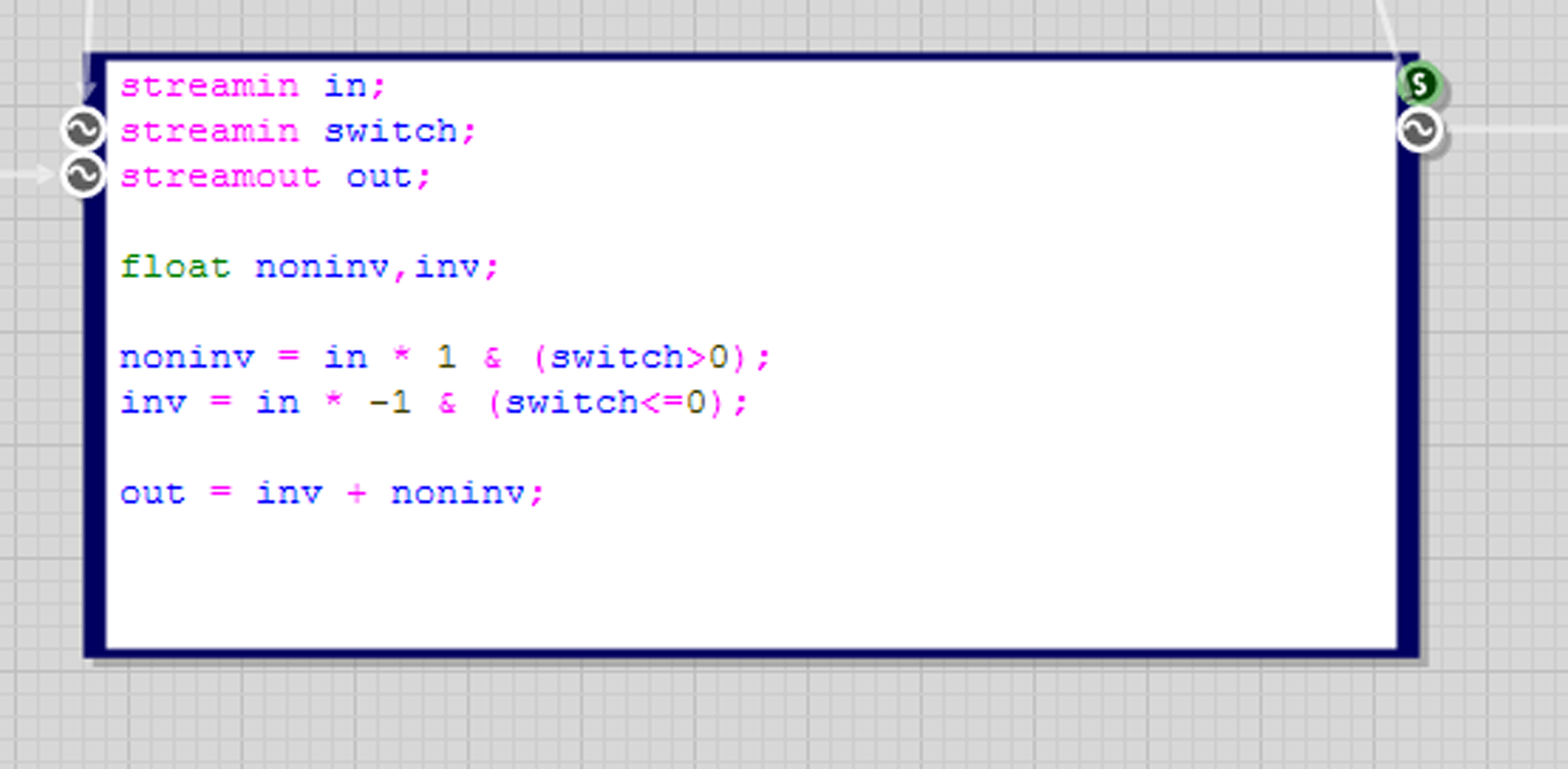

Here's a poly stream-controlled inverter I knocked up, together with a demo test synth attached.
I wonder if this could be made more efficiently in DSP code...
- Stream controlled inverter -Spogg .fsm

Hey Spogg,
thanks for participating! Interesting question. I came to the conclusion that basically you only care for a sign switch (positive switch input = +1, negative switch input = -1). I always look at all modules, Martin shares with us. In the past, it didn't help me the slightest bit. But now that I slowly start to understand the dsp editor, I remembered that I once saw a sign bitmask in some of Martin's modules.
I have no clue what exactly is happening to the bits, but I know what a sign function does in higher level programming languages. And since it is a bitmask, I knew I had to somehow bitwise combine it with the switch. After several tries, I came up with this
The final code then looks like so:
What do you think? And what do the DSP gurus think?
sgn = -1&-2 //sign bitmask defined in stage 0I have no clue what exactly is happening to the bits, but I know what a sign function does in higher level programming languages. And since it is a bitmask, I knew I had to somehow bitwise combine it with the switch. After several tries, I came up with this
1|(switch&sgn) //results in either -1 or 1The final code then looks like so:

Yup, tula's inverter does the same as Spogg's and is more efficient.
It is probably not meant to be used as in the schematic because it aliases quite heavily.

Hey well done tulamide!
Nobody noticed I got the inv and noninv names crossed, not that it matters for the result.
My first attempt was to get the whole job done in just one line of code, but I failed to find a method.

Re: tula's DSP modules
tulamide wrote:Code: Select all
sgn = -1&-2
There is actually an even simpler method to get a sign mask in dsp code:
float signbit = -0;Unfortunately you can not use xor in dsp code, otherwise one could simplify the code to
out = in ^ (switch & signbit);This is why I don't like the dsp code module, it is limiting because it doesn't have all the features and the generated asm code is poor.
