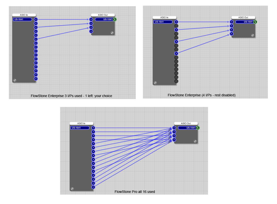

A good example of how the ASIO limitations work is to look at a multi channel audio interface like the Tascam US-1641. This has 16 inputs @ 96Khz, in FlowStone Enterprise only 4 will be available at any one time, in FlowStone PRO all 16 are available.
ASIO in FSE explained:
ASIO FES.png (91.23 KiB) Viewed 24994 times

That Absolutely clears that up!
Thank you.
