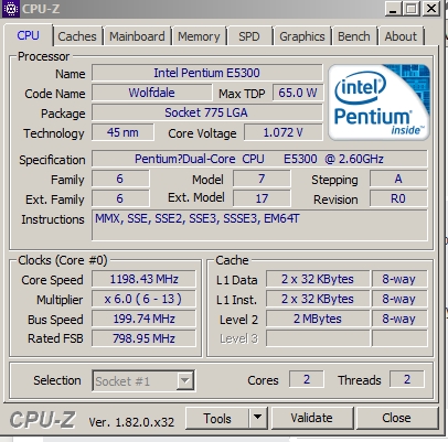

I have installed 3.0.8 and every time I try to load a schematic I get a message that says my computer does not have SSE (Streaming SIMD Extensions). I ran a program (cpu-z) that gives that data, and of course I have SSE.

I tried installing 3.0.8.1 and I keep getting an error message that claims I do not have SSE on board (SSE replaced MMX years ago).
I ran a program to check my computer (cpu-z) and of course I have SSE.
So now we know that 3.0.9 is a bomb, 3.0.8 and 3.0.8.1 will not run, so I am now running 3.0.7.

Hello TSt,
I am running Win 7, fully updated.
I have enclosed a screenshot of the cpu-z report.
It seems that I do have SSE, my guess is that the other versions would not run without it also, but they do .
