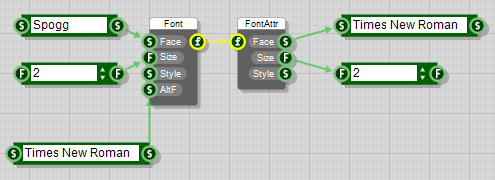

Oh my! I'm using Flowstone since 2013 or so. You would think, you've become an expert in over a decade. But no, instead I still learn something new every now and then.
For example, today I found out, that my solution to your problem is already built into the Font prim (should you make use of it). Just provide an alternative typeface at the appropriate input (see image below). :oops:

tulamide wrote: ... today I found out, that my solution to your problem is already built into the Font prim (should you make use of it). Just provide an alternative typeface at the appropriate input ...
I didn’t know about that either! Always something new to learn, eh?
However, your Ruby system is way better in my view. I can tell the user they don’t have the right font installed and use it to change the wireless font name string to send to all my knobs etc.
I guess you could use a “string equal” comparison, but your solution is far more elegant.
