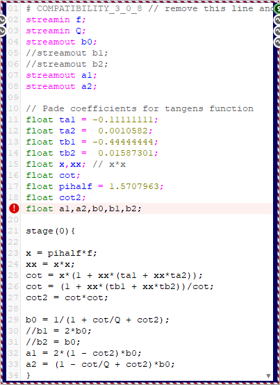

I have noticed that three of the cabs don't work (Green 25, Basket, and Recto), and I apologize because it is my fault. There is a bug in the coefficient calculation for the high cut filters (and in Recto, also for the highpass filter):
Please remove the offending line
float a1,a2,b0,b1,b2;
Apparently FS3 was more permissive than FS4 is. I still develop much in FS3, but I have made it a habit to always check with FS4.

I followed your recommendations and removed the extra lines in the filter coefficients. Now everything is in its place. But I won’t publish it yet, because I want to understand the Preset Manager module in detail and write several presets for ease plugin use. As for the authenticity, I can say that since 1960, when the first AC30 appeared, there have been many modifications to the circuits that were significantly different, and I cannot speak of complete compliance. The main thing that remains is the 2 channels Normal and Top Boost and important the original Tone Stack, to the extent that I was able to do so. As for Brian May, his combo only had one "Volume" knob, which I think implies a modified circuit. These combos were produced in a limited edition, I think about 500 pieces. It's obvious to me that this combo has SAG due to the use of GZ34 in the power supply. Therefore, I decided to introduce the SAG knob, and to reduce the “sand” I introduced the Damp control. Depth and Voicing are taken from modern amplifier circuits. The SAG knob is also available in some VST plugins, such as S-Gear (Scuffhan). I decided to make it more “noticeable”, saturated in sound. In general, what got is what I got. In addition, BM used a 6 pence coin instead of guitar pick. This also radically changes the sound.
