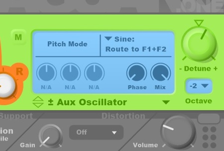

You tackled "adding the odds" module as well, and it can be pushed further in one direction than my original so... and 4x faster (straight out of the Aether) is no small gain either. That's half the victory won since i'm on a budget because of my :?: "feature creeping" synth... as Kevin or perhaps Spogg would write :lol:
My plugin is horrible to work with (no not because of all spaghetti ;) :D but the size!). So it's gonna take a while before I throw these in, since i'm modifying other aspects of the plugin also right now.
I'm going to look at these modules closer and test the performace later. You and Tepeix took a different approach which is nice...
I highly suspect Tepeix version works well inside my LFO, because there I only need the Split Exp functionality... and MV's version for the Aux Oscillator.

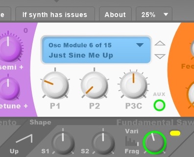

This will be a DAMN NICE update (subjective for me atleast as newbie :lol: ) when I eventually finish it, since it adds some more possibilities for variation...
Knobs already in place from previous version... ;) for the knobs needed for your ASM:ed Split Exp and Mix-in Odds modules.
Slice and Frag modulatable, now with Vari modes. Either retains/adds some sizzle at high reso or makes a trash:ier sound... Fit perfects for the plugin since it's a techno synth.
Also thinking of making a Random mod section for Note pitch, Amp, S1, S2 and Slice/Frag. Based of Adams random ASM snippet that I think Spogg shared here somewhere.
Might take look at my Envelopes eventually. Have some idea that I'll lock MV's exponential AHDSR to a ADSR. Gonna take a look at the ASM maybe I can alter it for linear on my own, as I need both (linear and exp).
