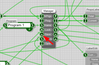

billv wrote:Why....?????
When using VST , the user can just save into a Preset Manager slot.
wouldnt it be enough to just trigger the save input of the pm primitive?
just installed greenshot to make screenshots and easily put arrows and stuff on it :lol:
