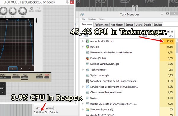

I am making a plugin that has a few moving graphics , a scope , running bar indicator etc.
It takes very little or about 1% cpu in FS but about 14% in Reaper , but only when the GUI is closed.
When GUI is open its about 40% !

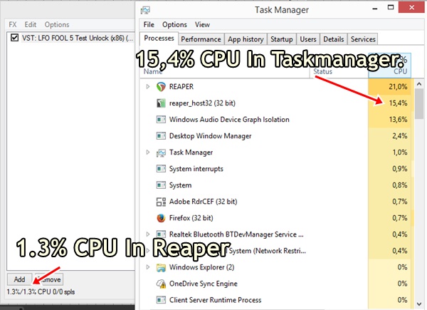

I gather that the discrepancy between the CPU reported in Reaper and the actual CPU use is because it runs as another process due to the bridging ?
Is it normal to have a 1% CPU in FS and then up to 40% in Reaper , It seems reasonable that it takes a bigger hit as a VST but it seems excessive.

Re: GUI + CPU.
The CPU Meter in flowstone shows only CPU used by the Stream section.
Graphics in flowstone are not hardware accelerated, it all has to be drawn by the CPU.

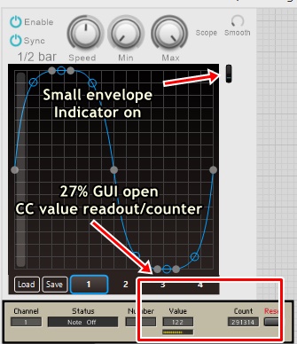

Ok, so I did some testing .
The test shows :
Testing most recent CPU hog version in Reaper - 40% with gui open -turning off the scope on the VST changes nothing, which is interesting because removing the scope from the FS project -exporting as VST has a significant effect. I wonder why that is ? In FS I shut off the input to the scope with a multiplex.
Removing the scope has the biggest effect ,admittedly I needed a scope with 8000 samples for it to be useful and in fact I would probably need more and its a dual scope pre and post,but interestingly I had 3 moving indicators and all of them had a large effect.

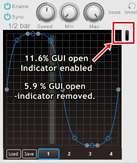

1. One tiny indicator (tiny scope used as an indicator) with 16 samples 100 ticks used as an indicator for the envelope movement.
2&3. An indicator/knob for the CC value ( not needed on the interface, just for testing) and a counter for the cc.
So... I tried a few variations for these indicators to see what was hogging CPU.
1.
Scope removed , midi cc indicator removed - small envelope indicator 11.6% with the gui open
Scope removed , midi cc indicator removed - small envelope indicator removed 5.9% with the gui open
So the CPU is halved by removing that indicator/Scope
2&3
Scope removed , midi cc indicator intact - small envelope indicator intact 27% with the gui open.
Again , CPU doubled by a small moving indicator.
Best results so far were obviously with Scope removed, CC value indicator removed and small envelope value indicator removed. This gave me a result of 6% CPU with the GUI open and 0.3% with the GUI closed.
I could get this down by removing the running position bar.
So I tried that .
Scope removed, CC value removed, small indicator removed, running bar removed. In fact , all moving graphics removed.
0.9% CPU with GUI open!
I was not too surprised that the Scope was hogging the cpu , but I have to admit that the two tiny indicators , one of them a scope and another a bmp , both seem very heavy on the cpu ?

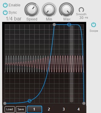

Comparing the cpu use to something similar like LFO tool from Xfer which has all these and more moving graphics and only uses about 4% CPU , it is however all written in c++. Interestingly when I turn on the scope on that plug it does indeed jump to about 40% cpu !!

The test shows :
1.
2&3
So I tried that .
