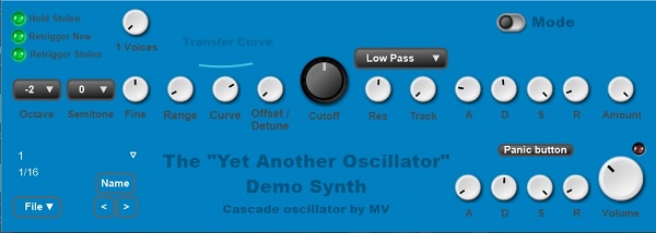

Ok. This oscillator seems to have ended up in my Aux Oscillator together with a phase offset:ed Sine... As a "squiggly sine" waveform...
MV I have a little question
The visualisation you made of the transfer curve. No chance I understand or can deconstruct the math
Does the lower most left corner of that box represent the origin of the curve or the way you applied the curve in your math? Or is the origin right in the middle of the box like a typical parabolic curve example commonly seen?
Re: Yet Another Oscillator
Sorry I didn‘t explain it well. The origin is at the center of the square, axes are missing. x goes from -1 to 1, and so does y. The transfer curve has to stay completely within the box, else there will be a catastrophic amplification of partials.

Nice! Also looks a bit cooler as a small visual with a crosshairmartinvicanek wrote:The origin is at the center of the square, axes are missing. x goes from -1 to 1, and so does y.
martinvicanek wrote: else there will be a catastrophic amplification of partials.
