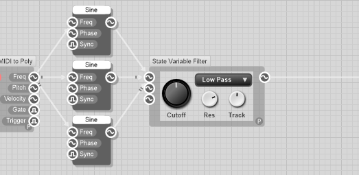

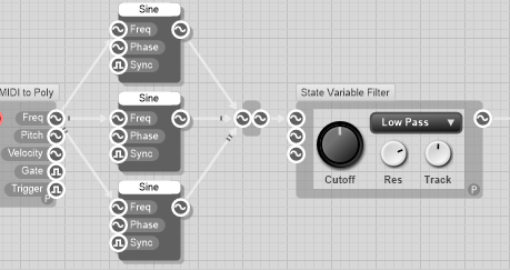

Since I only read rumours about it, I would like to get a definitive answer (MyCo? Martin?). Two screenshots below, and it is only about the wiring. So please ignore that you see three times the same osc, or that they all are at the same frequency. Just assume different oscillators or different frequencies. The question is if either of these are valid connections? If not, please explain why not. This question is important for me, since I will have a whole bunch of oscillators that will produce sound on the same midi input, and will all share the same effects. I magining that I would have to build a seperate filter for each oscillator, etc., until I convert to mono streams is horrifying.
Is this a valid connection of streams?
And what about this? Still valid?

Yes its perfectly valid, but using it like that, you are just adding three different waveforms together producing a new waveform. On that pic, it will simply become a three times louder sine.
Re: Adding Polystreams
adamszabo wrote:Yes its perfectly valid, but using it like that, you are just adding three different waveforms together producing a new waveform. On that pic, it will simply become a three times louder sine.
Thank you, Adam! I really needed this confirmation. I will be playing around with 30-40 oscillators, so that was a big issue of uncertainty for me!
Regarding your objection, please notice that I said:
tulamide wrote:So please ignore that you see three times the same osc, or that they all are at the same frequency. Just assume different oscillators or different frequencies.

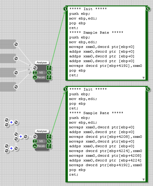

stw
Posts: 111
Post by stw »
KG_is_back wrote:It might be because with add primitive you can parallelize the adding. If you just use plain connections the resulting code is equivalent with: out=((a+b)+c)+d
With add primitives you can arrange the additions into a tree: out=(a+b)+(c+d)
processor can then execute (a+b) in parallel with (c+d). However, the improvement will be rather insignificant - you save about as many CPU cycles as you have connectors, since float addition is only 2-4 cycles to begin with...
Are you sure?
Parallel processing on poly stream is always acting on the packed 4 mono streams and not on doing equal operation from different places. In fact using add prims is introducing some overhead because it has to store the interim results and therefore should be slightly slower (as you can see in the image).
KG_is_back
Posts: 1196
Location: Slovakia
Post by KG_is_back »
stw wrote:Are you sure?
Modern processors use pipeline. Each instruction is executed in stages. Processor can start executing next instruction before the last one has finished, unless the next one expects input from the last one. Also, they load instructions in chunks and execute them in the most favourable order, to maximize the usage of the pipeline.
stw wrote:In fact using add prims is introducing some overhead because it has to store the interim results and therefore should be slightly slower (as you can see in the image).
Yes you are correct about that one. I forgot that flowstone does that...
