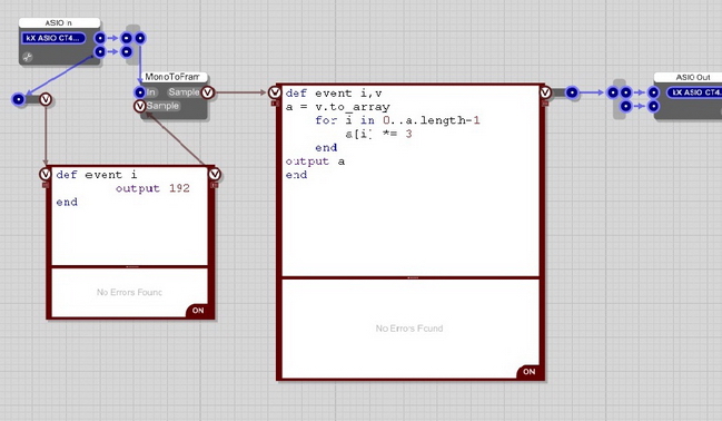

I tried to deal with the mono to frame component module ( with number of samples to grab ), but without success... :?
So please post little example how to use it ( with ruby component desireble )! ;)

Solved.

For instance: what happens if the soundcard's driver latency is 128 samples and one would request 192 samples at once? (or am I misinterpreting the "output 192"?)

Thanks for your swift response, TomC. Not sure if my message was formulated clearly enough though, so let me try to rephrase: In the given example I mean the case where the blocksize is 128 samples and then an unequal 192 samples are requested (i.e. not a multiple of 128). Would the total delay then become 256 samples :?:

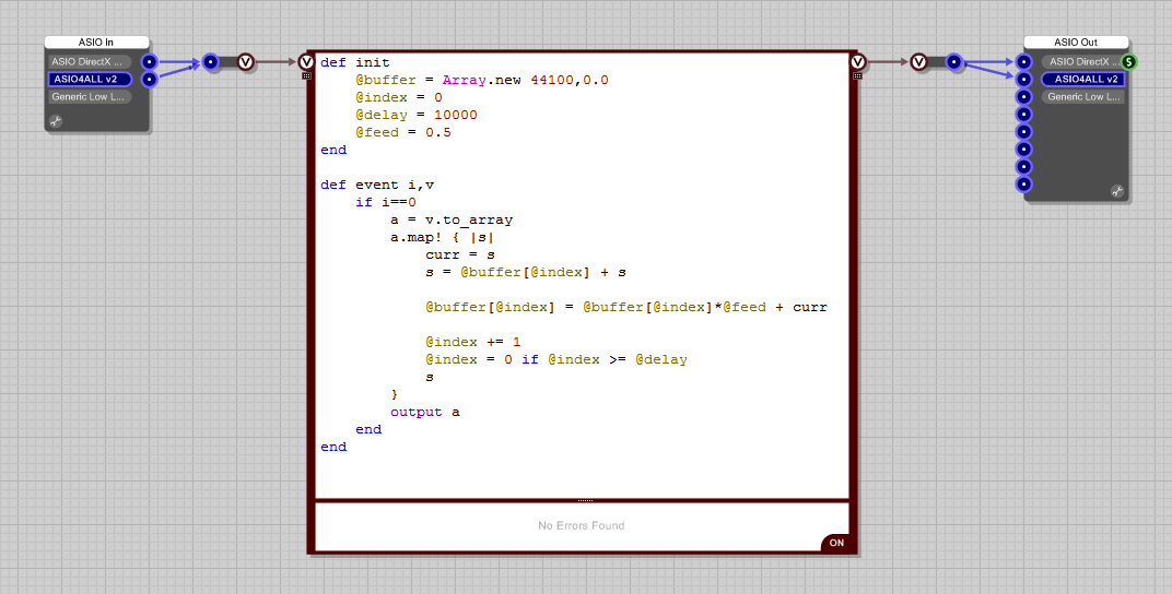

If you're wanting to process all the samples that come on a Mono stream then the way to do it is as shown below. This implements a simple delay effect. I've attached the schematic for you as well.
frames delay.jpg (353.48 KiB) Viewed 28455 times
The Mono to Frames component will give you each buffer as it comes.
Your solution using the Mono to Graph will work if your buffer size is 192 but if you change it then you will get anomalies in the audio. Let's take the example TAD has suggested. If your audio card is set up to work with 128 sample frames then each time one of these is requested at the ASIO Out, you're grabbing the last 192 samples instead of the last 128. The ASIO Out will still only use the first 128 of these but because you grabbed 192 the start sample will not be correct - it'll be shifted back by 64 samples, hence the anomalies.
The Mono To Graph can be used instead of the Mono to Frames in this scenario if you use the Frame Sync component to supply the buffer size.
Mainly the Mono To Graph is used for analysing signals. It allows you to grab samples at lower than sampling rate and specify exactly how many samples you want too.
