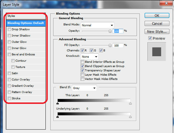

I tried to teach the manual, and do a good graphics on FlowStone, but always turned out not what I wanted, and I began to create their own palettes and styles in Photoshop, especially for plug-ins, and to be honest, this is the most convenient way to create a wonderful skins and more more ... one of their own palettes I called 100% juice, and use it to this day!
