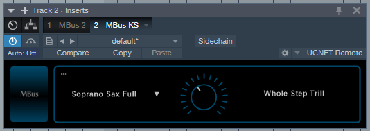

I have another question (for anyone really).... re: automation and presets and all that. I have a pretty good grasp on how presets work for automating things and everything is working fine except I cannot figure out how to push the value being displayed in the daw as text to the timeline envelope. In the image below you see a value correctly being displayed from a knob on my plugin (0-1 translated to ranges for key switches via Ruby) ...
... but after trying all of the inputs on the preset prim I can't seem to push that value to the actual envelope value display...
I can see it working with other plugins in the host like below where the tone generator combines text with numbers and shows the true value on the envelope as it's being adjusted...
... and I'd really like to do the same with the key switching parameter, show the actual articulation names as I adjust the envelope, not just 0-100.
Thanks.

Here is one version of the plugin. It's a pretty simple thing, a plugin that allows automating sampler key switches with timeline envelopes instead of midi notes in the midi editor. This version is a sub-set of a larger plugin that also includes that functionality...
