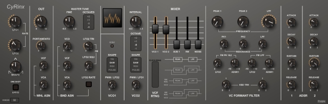

A spin on the Synton Syrinx, it's main attraction being a very unusual filter arrangement: two Peak filters in parallel that could be connected in series or parallel with a 4-pole LP. Each Peak has independent freq and res controls with LFO and EG mods in common. The LPF has it's own LFO and EG mod controls. The Peaks and the LPF also have separate keyboad tracking. Wow.
The Syrinx had a single two-prong 'touch-pad' in place of bend and mod wheels. So I included sensitivity/destination controls for both bend and mod wheels.

Also the panel can be grey, purple, red, blue or mauve.
Those who've already downloaded CyRinx, re-download it - made some tweaks to the peak filters and the scope.
