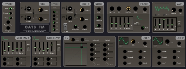

An alternate version of cutOats, with FM oscs:
OatsFM -

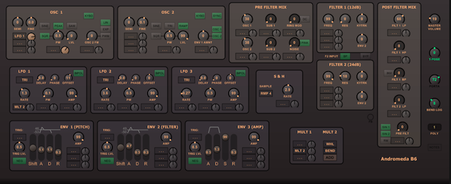

Let's see if I can explain this verbally.
Open 'New GUI Elements'. Then, up on the header click on Toolbox>New Group. Give it a name. The new Group will show up over on the left. Click on it to open it, then just drag the new GUI elements into it. Close all, then open b6 and one by one drag the new elements into the appropriate modules and then delete the old ones. As I said before you may have to right-click on the new elements (from 'outside' the module; unlock it first, with the padlock icon.) and and select "Send to Back", to put them in their proper place.
Those are instructions for SM and not for FS right? Anyway, it wasn't that difficult after all. After opening the b6 project and the new gui elements project in the same Flowstone instance, I could copy and paste them over.
I hope it shows like you intended K ?
Please give it a look here: http://i383.photobucket.com/albums/oo27 ... hwm7h4.png
Downloadlink is here: https://drive.google.com/drive/folders/ ... sp=sharing

I've replaced b6 in the main folder with the refreshed GUI that Knob Twiddler did (thanks!).

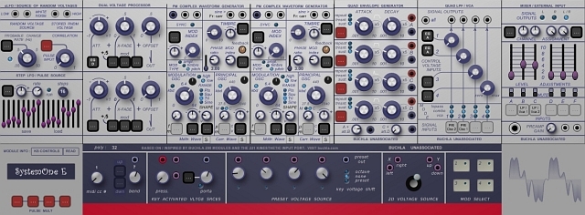

I went ahead and did one of the larger Buchla approximations, even though the Random sources are only a very rough stab and a stepLFO standing in for the Sequential Voltage Source. Still, I think, another interesting look into the Buchla way of doing things.
For those unfamiliar with Buchla modules, what we have here, left-to-right are:
-Random voltage sources and a step LFO.
-Dual Voltage Processor (adder, attenuverter, modulatable cross-fade).
-Two combination LFO/complex oscillator.
-Four Envelope Generators.
-A Four-section low-pass filter/vca.
-A six input mixer (two inputs with modulatable pan).
-A joystick with four seperate outputs: center-up, center-down, center-left and center-right.
-Various keyboard controls and four freely-patchable Preset Voltage Sources.
There'd be a Partridge In A Pear Tree, but it leaves a mess on the floor.
I used normal human language for the Dual Volt Proc, instead of math-speak ;- )

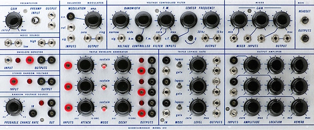

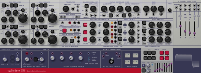

And before beddy-bye, param-names for The Dodeca 258c discussed earlier in the thread.

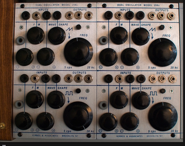

This Buchla approximation is quite different, being built around the Dodecamodule - virtually a complete synth in itself, but without oscillators. The Dodeca 258c adds approximations of a pair of 258 Dual Oscillators, a Four Channel Comb Filter, controls based on the 221 Kinesthetic Input Port and a stepLFO.
