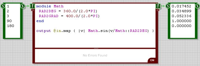

Re: Process an Array in Ruby
With RAD2DEG and RAD2GRAD module.
- sin_array_1.fsm
- (486 Bytes) Downloaded 1498 times
- sin_array_2.fsm
- (534 Bytes) Downloaded 1496 times
Thanks, both of you.
My input is in degrees, how do I format it so if I put 180 in I get a 0 out? e.g. sin(180) = 0
Ollie
