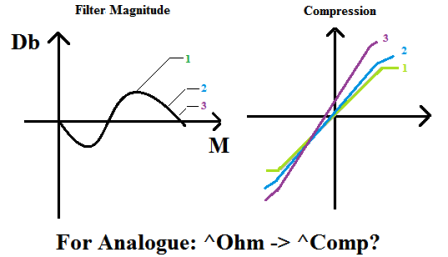

When we talk about filters, we are talking about magnetude ... I want to learn more, you can simulate resistors сомpression ? :?:
Filter Compression.png (23.35 KiB) Viewed 34177 times
KG_is_back
Posts: 1196
Location: Slovakia
Re: Double-T-Filter
Post by KG_is_back »
very interesting. I always wondered how to simulate electric circuits but never had a clue...

DigiTonix
Posts: 137
Joined: Sat May 07, 2016 11:28 am
Re: Double-T-Filter
Post by DigiTonix »
Hey ... BobF thinking right ...
I also want the different components of the flow !, different diodes, lamps, resistors, and other ...
Martin, is this possible? to make different types of chain links (I'm talking about analog circuits) ...
