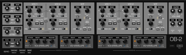

Some OB-2 bugs pointed out at Music-Society (fixed) and I added a feature not on the Two Voice: Voice #1's oscs can be re-routed to Voice #2's filter, for processing big 4-osc sounds through a common filter.
Like the SEM Eurorack module, I added Saw to the LFOs.
Also tossed in the OB-1 manual.
https://www.dropbox.com/sh/94zkxdb9je9x ... IV5ja?dl=0
OB-2 copy.jpg (89.72 KiB) Viewed 33180 times

OB-2 has been rather extensively up-dated with new features.
-OB-1 had env mod of VCO 2 only; OB-2 now has env mod (VCF or VCA) of all four ocs (like SEM Plus).
-Cross mod changed from switch to continuous control.
-Noise level changed from switch to continuous control.
-Saturation effect comes in when out levels go above 12:00.
-Feedback added to Filters.
-Voice #1's oscs can be routed to Voice #2's Filter.
-External input added to both Filters.
-Saw added to LFOs and Vibrato.

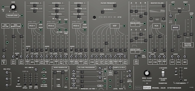

tonus 2620 (ARP 2600) now should be Automation-friendly.
https://www.dropbox.com/sh/xt1xoykr2903 ... LkD0a?dl=0
tonus 2620 copy.jpg (179.12 KiB) Viewed 33180 times
Pretty proud of this one - beta-test away; this one deserves a good fine-tuning.

... just launched the CM edition of SM (no, it doesn't open your .OSMs - I didn't expect for one moment that it would), and think I might have spotted something. (I won't take offence if anyone who actually has a clue points out that what I'm about to say is really dumb.)
The 2620 was probably the 'standout' of this outstanding bunch, for me, right from the start (so please, folks, test every last drop out of this one!).
It was also the only one (that I recall) that can only load patches, not banks.
I'm guessing this one lacks a module called 'Preset Manager'?
If so - can you please drop one in, give it a 'Total' count of 50 (like the others) or (even better!) 128 (the maximum number of programs for a VST bank - let's encourage all those talented sound designers out there to really go to town on this one!) and toggle 'Show In Parent' to off.
With any luck, this won't even 'break' any patches I try to make in the interim.
And if it turns out that what I've said isn't too dumb (beginner's luck!), I might even feel encouraged to dive in a bit deeper and see if it's worth getting FS (or at least the demo) so I can try to contribute in more practical ways (a la KT).
Oh - I almost forgot: Thank You!

The Preset Manager was already in there; as I recall when I first started bashing about with SM (at first, the CM edition), exporting as vst isn't possible without the PM in there. I raised the max to 128. If you're using vstHost, I thought the internal PM wasn't being used. I know the saving and loading of .fxp doesn't use it, but maybe it's different with .fxb - I've never created any banks.
Intereseting that it wouldn't load the schematics, I thought the only limitation to the CM edition was that it wouldn't create schematics with more than a certain number of modules - didn't know it wouldn't open them either.
Will be curious to know if the change to 128 max allows you to do what you want.

What should the 2620's Parameters '#000' and #001' do?
Yes, I only started with Synthmaker CM.
I may do the Buchla called SystemOne D, but I'm inclined to wait on Music Weasel and the others till I can get some help from Spogg or someone with the sequencers and the random voltage modules. Anyone trying out a Music Easel emulation is going to expect a proper sequencer, and the step LFO isn't even close. I was praying that some Flowstoner had familiarity with the Buchla Source of Uncertainty and help out with a rough approximation of it; I know my attempt is a joke at this point, largely because there is so little info online regarding exactly what it does and how it sounds. The random sources in the Music Easel were much simpler and what I did in Weasel is probably somewhat close. SystemOne D doesn't have random voltage sources or a sequencer, so I'll do the automation fix on that.
I haven't been able to figure what's generating those #000, #001. Got the same thing in tableBlend which I just finished.
