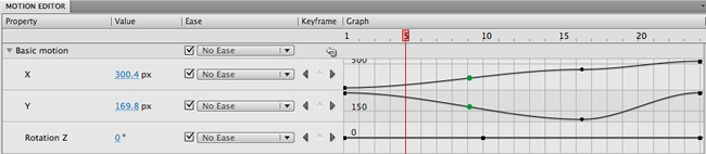

Here is something like I want to do...
Simple Time Line Editor
Imagine a few more control lines, and those control outputs going to other primitives in the schematic to control gains, and frequencies of oscillators while the wave (audio) file is being played. Then all of the resultant data is output to ASIO to my DAW (Reaper) that records it all for final assembly / editing / cleanup and playback of the animation / lighting scenes. I know DMX does something like this, but my data streams at the sample rate - and I need that fast a data stream.
