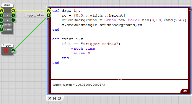

Hi all guys! I hope you can help me again ;)
I don't understand why I'm not able to call a redrawing of my View clicking on the Trigger button:
this should be pretty easy. Every Trigger click, a new Background color (notice the rand() function). But instead, only time in the "watch" zone change.
trigger redraw 0.fsm
(441 Bytes) Downloaded 869 times

It does redraw the view. You just need to go to the toplevel to see it. It's better if you have the trigger button one layer higher, so you can observe it better, like here:
trigger redraw 0 [tula].fsm
(456 Bytes) Downloaded 825 times

I see. Thanks! My problem seems that I can't "prevent" redraw:
def init
   @doRedraw = false
end
def draw i,v
   if(!@doRedraw)
      return
   end
   rc = [0,0,v.width,v.height]
   brushBackground = Brush.new Color.new(0,80,rand(256))
   v.drawRectangle brushBackground,rc
end
def event i,v
   if(i == "trigger_redraw")
      @doRedraw = true
      redraw 0
      @doRedraw = false
   end
end
I'd like to "draw" only when I got a trigger (or an array Ruby input, for example) as input, not every time FlowStone invoke a general "redraw". Waste of resources for a controlled Area...
For example here, I'd like to change color every time I click on the Trigger button, not when I click on FlowStone workarea (that will invoke redraw inside Ruby).
trigger redraw 0_when_I_want.fsm
(494 Bytes) Downloaded 834 times
