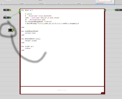

I have started to use ruby selectors. and the problem is I want to get the ruby color module. Which code do I need to add Ruby code to get out it?

djbrynte wrote:Which code do I need to add Ruby code
Drawing color via Ruby is explained well in the manual, starting at Page 142.
Lots of examples using ruby colour are already in your toolbox..eg: "knob", "label"....ect
Anyway, here's some simple demo's stripped down on this fsm,
and also a more complex method of creating lots of colours at once.
Hope this helps.
PS. Don't forget the manual.
