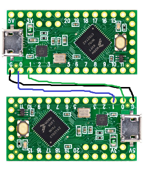

You could build this kind of setup with two Teensies (one for each machine) and the only connection between the two Teensies would be the Tx and Rx pins would have to be (cross) connected. You'd still have to program the Teensies to pass the MIDI data but it would be fairly cheap to build and much more compact than all that cable...(Teensy 2.x are $16 each!)

Of course that's easiest but you could do the Teensy thing for about $40USD and the entire 'build' is basically three wires and six solder joints.
And because its USB-MIDI compliant you don't need drivers on either computer to make it work.
Because you don't need 5V for DIN MIDI and you don't need high speed for MIDI baud rate but you do want a USB-MIDI compliant board the Teensy LC (low cost) is the obvious choice for this.
The BoM is:
* Teensy LC X2
* 2 USB A to micro cables; ~$26
* USB micro cables X2; ~$10
* Tiny enclosure; ~$4
You'd likely want the USB micro plugs to sit inside the box with the cords existing from notches on the body where the lid fits so it would need to be quite a bit longer than the 35mm the board requires -- but it could still be quite inconspicuous compared to the iConnection thing.
So... unless soldering is out of the question for you then the only real question is the programming.
All you really need to do there is to take each supported MIDI event (or all if them, but if you're controller doesn't do sysex or polyphonic after-touch you probably don't need to pass them!) and read all incoming messages then send out the same outgoing message passing on the parameters.
While all the data may be one way you could still put the same sketch on both Teensys and it should still work (and that way you could connect the cable in either direction).
I can't really write the code now as I don't have a Teensy that isn't in a project box all wired up at the moment but I suspect it would be very easy.
If the Spanish device isn't available (or doesn't do what it seems to say on the box - en Español) and you REALLY want a smaller footprint or REALLY want to save $60 I think it's a viable option.
