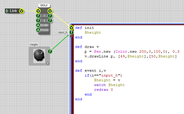

This is the situation I have:
I'd like to redraw the line (i.e. its height) every time I tweak the knob.
I can see the value change using "watch", but the line is not redraft. Where am I wrong?
Hope you can help me.
Thanks for your time, as usual!

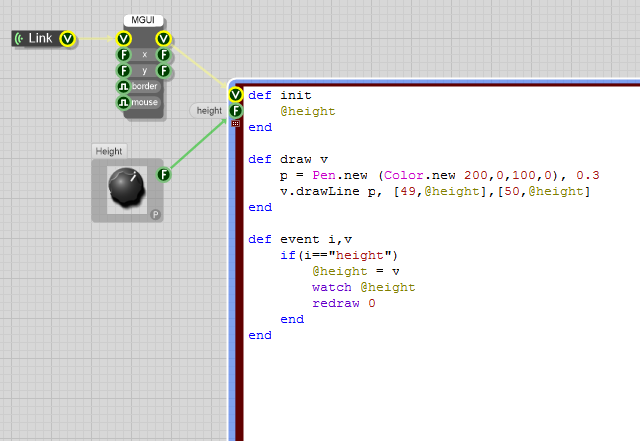

All inputs you name are automatically converted to an instance variable. So your input "height" is also available as @height. But you also declare another variable as @height. Rename one of them.

tulamide wrote:All inputs you name are automatically converted to an instance variable. So your input "height" is also available as @height. But you also declare another variable as @height. Rename one of them.
Uhm, nothing change :(
moving knob, I can't see any redraft....

Oh no wait, it works! Just I can't see move it in the preview in the top! Thanks ;)
