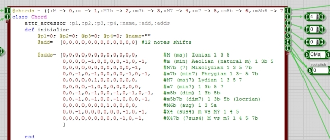

Now, to be honest, I don't own a business and I'm not selling VST pluggins; at least, right now. I'm just learning how to use this beast called flowstone because it's the most productive development environment I've ever had the chance to use in my life. It's so "straight-forward" that I didn't even need the documentation to create a complete synthesizer with it, for the first time.
By the way, regarding the syncronization, I made this VST using flowstone without ruby frame for sync, and it works with no important issues here.
It's got 2 arp/seq modes, arp notes indexes (as common arpeggiators) and chord mode for the sequencer, which studies the scales following scale mode rules (lidian, mixolidian, ...) as you can see in the figure:
Although it's not finished yet (because I have more works in progress), I hope you will enjoy the instrument and catch the idea.
