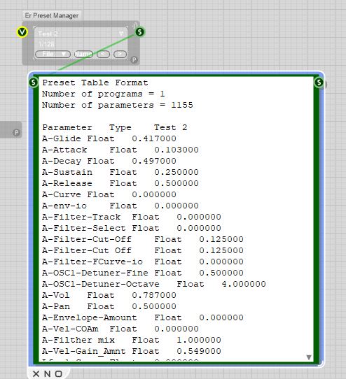

I find myself almost in a similar goal,
I try to call a list of automatable parameters of the schema within the same FS, and still can't find the way,
Now I think I have to find some primitive to open the preset txt and based on that data, filter the parameters that I want to activate or deactivate in the Vsti, or simply see them to find them more quickly,
I will elaborate it and if it works for me, I will attach it.

I did it, it was easy, I just added a primitive text load that extracts the content of a txt, of the file dialog menu,
which can be in any other assigned extension and voila, :D
ErvSoft- Lista de Parametros (FS v306).fsm
Parameter list extractor (made with FS 3.0.6)
(11.58 KiB) Downloaded 1081 times
then in this preset manager that I modified, you put it in your scheme and when saving or loading the preset,
the list of parameters will be written to the green table stings.
Image of preview scheme
2021-01-20 00_11_18-.jpg (68.73 KiB) Viewed 13039 times
