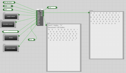

I try to get UDP Messages from a UDP server.
It should work, when I look with a other UDP monitor I see the UDP server sends the requested data.
But with the udp.fsm program I receive only the transmitted data.
Is ther somebody with a good suggestion what I have missed?
I have read Component Reference.pdf page 316 And is so clear that its almost impossible to make a mistake :)
Best regards,
Rob

I know what the problem was, my incorrect handling of the fs client port number.
My microcontroller server now looks to the port flowstone has choose.
receiving 128 bytes
receiving 128 bytes
