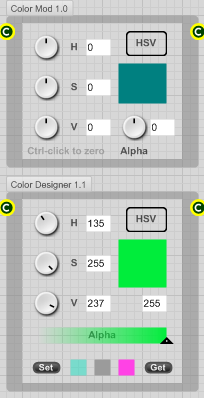

I made a small dev tool for creating and tweaking colors with a graphic interface without having to rely on the Windows picker. Notably, it switches seamlessly between HSV, HSL, and RGB color modes.
I'm planning to create a related tool next, but I figured I'd look for feedback on this first, since it will be similar. Hopefully I didn't leave any loose ends (it is a bit hairy on the inside). But let me know what you think or if you find any problems.
EDIT: Version 1.1 now includes working color banks.
EDIT 2: Added new module: Color Mod
This adjusts an input color by adjusting the component values. Also supports HSV, HSL, and RGB color modes.

My intention was to make this module work efficiently even for real-time changing color input, but note that it puts out 4x the triggers as the input, and I don't know of a way to fix this since trigger blockers and sample and holds don't work with color links.
These were the two tools I planned to make. Please let me know if you find any problems.

Minor update: just added some inputs to the color mod so the parameters can be controlled externally.
