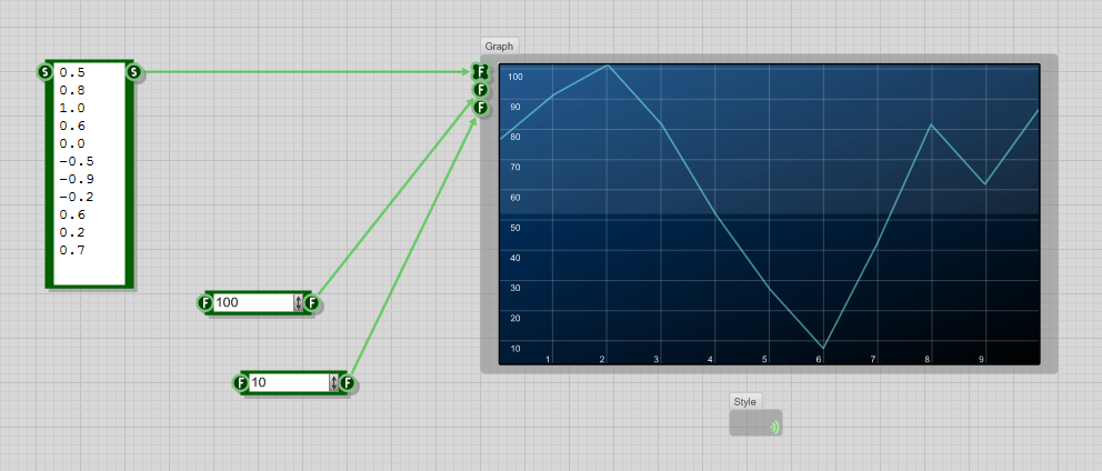

Is there a way to create x,y data graphs (Floating point numbers)?
support
Posts: 151
Re: Graphing Data
Post by support »
There is a Graph Module in FlowStone that takes an array of floats and draws a graph. If you look at the FFT Module you will see how it is done.
eg.
Graph clip.png (92.82 KiB) Viewed 18062 times
Graph.fsm
(3.41 KiB) Downloaded 1106 times

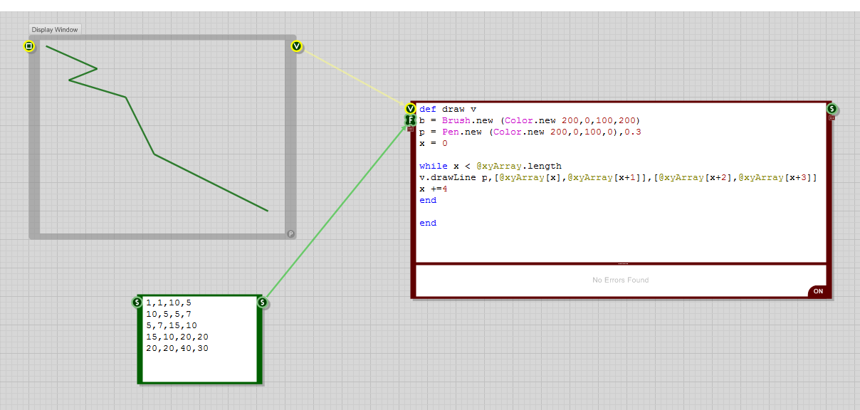

These displays appear to output a graph of a floating point variable and time. Is there a way to graph two independent variables?
Eugene529
Posts: 4
Joined: Wed Oct 17, 2012 10:15 pm
Re: Graphing Data
Post by Eugene529 »
I would guess that the function I need to experiment with is the Point Array Lines. I this correct?
support
Posts: 151
Re: Graphing Data
Post by support »
Yes correct but now we have Ruby there is a better way:
Ruby Graph clip.png (55.1 KiB) Viewed 18063 times
Ruby Graph.fsm
(1.08 KiB) Downloaded 1147 times
