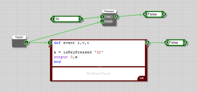

Is possible to detect the SPACE key using the isKeyPressed method ?
tks
tks
Re: Ruby isKeyPressed method
Space - is character 32 and in the Ruby isKeyPressed function it needs to be a string:
So SPACE = '32' (not 32).
For other letters is easier just use the letter eg. 'q'
