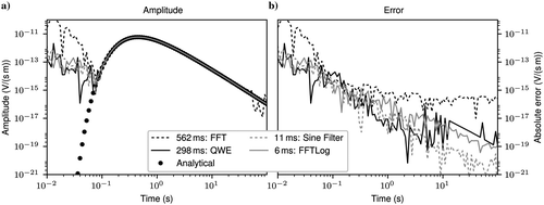

There's also some method called LFT (Logarithmic Fourier Transform) (PDF file link) I'm interested on but, dunno if it could be used... . Any thoughts?

If I have understood it right, LFT is implemented in python library "empymod" as FFTLog .... I could not find examples for to test it in audio application so, have to ask if someone of you have already tried if LFT/iLFT works for audio field applications (impulse response using cepstral processing as for an example) and what changes are needed to do for data compared to FFT/iFFT usage and is this all possible to port into FS? Compared to std FFT/iFFT, LFT seems to be "little" faster:
