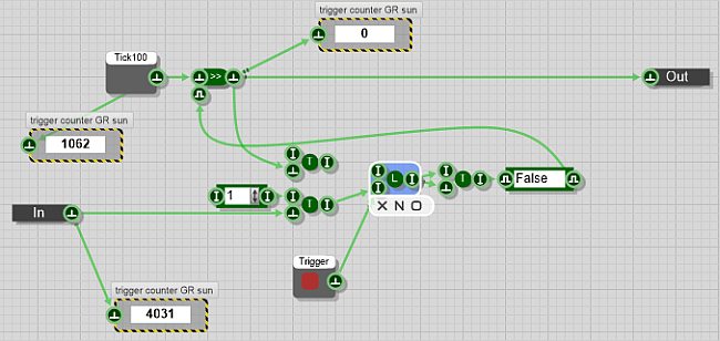

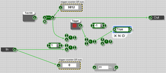

Hi,
i ignored 66 month's ago aliasants info here:
MIDI compatible timer:
http://synthmaker.co.uk/forum/viewtopic.php?f=7&t=4608&start=0&st=0&sk=t&sd=a&hilit=midi+compatible+timer
see External MIDI data on same process:
http://synthmaker.co.uk/forum/viewtopic.php?f=12&t=9724&start=0&st=0&sk=t&sd=a&hilit=Using+timers+with+MIDI
based on "Using timers with MID"I:
http://synthmaker.co.uk/forum/viewtopic.php?f=7&t=3673&start=0&st=0&sk=t&sd=a
I recovered an old project: MidiTrak Merger with only 25 Led's to show Midi action...
until now these Led's goes crazy after some time of hammering Midi Split triggers into them
some like to be dark some others lights always
I only touched this project again because Luddite gave us his ruby Midi Analyser some times before and it reminded me that i had one of my own wo ruby which crashes when 2 much data arrived...
P.S.: Is there a way in ruby to overcome this w/o firing always triggers (on a Bool OUT)???
here what i found after some digging into the De-Threader:
- De-Threader Off wo reason.png (100.92 KiB) Viewed 9257 times
- De-Threader ON wo reason inside Modul why Intsw TRUE.png (94.92 KiB) Viewed 9257 times
