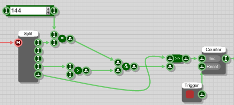

I'm implementing midi control by notes for my filter and I'm having a problem.
I want the filter to change (doesn't matter in what way right now) incrementally every time a note is played so the filter would go through 1-stage when the 1st note is played, 2-stage when the 2nd is played etc.
so I used
Midi in->splitter(changed)->counter->ruby
The problem is I also get an increment whenever a note is let go.
I thought of using:
midi in->midi to poly->gate->greater than 0->counter->ruby
but the white-poly gate out of the "midi to poly" can't connect to the counter.
any suggestions?
Edit: As expected I managed to solve part of the problem(but not really...) within the code with some comparisons and dividing... it solves the problem in the case of every note having a trigger in the begning and the end but if one note starts in the middle of another the solution is no good.

Not sure if this is a factor for what you're doing but many keyboards send Note-on with Velocity=0 instead of note off. That will give you double counting if you're not looking for it.
zoobooboozoo
Posts: 32
Joined: Tue Sep 23, 2014 12:14 pm
Re: Midi gate counter problem
Post by zoobooboozoo »
Works great so far thanks. (I'll have to figure out some code for chords as well. Maybe one that doesn't count triggers if they arrive at the exact same moment)
