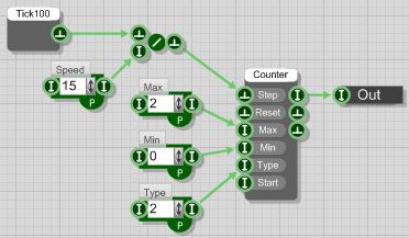

This one is very simple. No Poly to Mono, and it still crashes :? I replaced the Asio Out with Direct Sound but still i can make it crash.
Crash.fsm
Very simple crashing schem
(1.72 KiB) Downloaded 1045 times

I got really tired of clicking that Selector dropdown. I mean, like, reeeeealy tired. So i built an auto selector
It can crash any schem from this thread except if KG_is_back's code snippet is used. I opened my revised delay schem which uses the code Multiplexer. Then I connected the auto selector and went to have a smoke. When i came back it was still going strong. The schem uses both Poly to Mono and Asio Out prims. I could play notes happily and toggle Midi/sound IO on/off with no problems at all.
