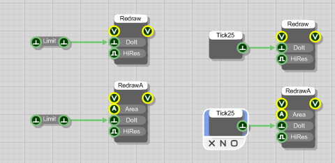

Is this the right way to do it?
Re: Parametric EQ: Smooth Automation
Ticker and redraw limiter are used to drive the redraw and redraw area prims (which are responsible for gui refreshing). Not there (although you could use redraw limiter your way too in some situations). Note that you must connect triggers to redraw limiter too.
The difference between ticker and redraw limiter would be - redraw limiter acts only when triggers are sent, while ticker sets constant refreshing rate for gui or area. Downside of ticker is - if you use it on editboxes, then your values may disappear/blink during editing.

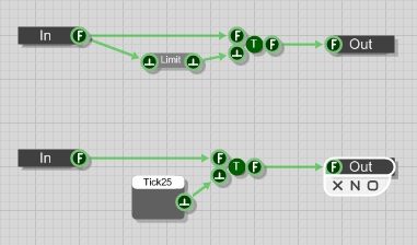

I wanted to limit the triggers when a value is constantly changing, like a De-Zipper for green. I used the redraw limiter like that and it kinda worked. I don't know if that's logical or not! And i am paranoid about using tickers, they tick a lot! Beside when there is no change in value they are still sending triggers.
I guess i have to experience more on this. But my original problem is solved.

Father wrote:I wanted to limit the triggers when a value is constantly changing, like a De-Zipper for green. I used the redraw limiter like that and it kinda worked. I don't know if that's logical or not! And i am paranoid about using tickers, they tick a lot! Beside when there is no change in value they are still sending triggers.
Thanks for your time, really appreciated.
Just play with it, and post schematics with problems you may encounter.
