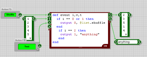

Why does hitting the test btn trigger the shuffle?..

because or 1 is always true in your syntax.
This should be right:
if i==0 or i==1

thanks mate. didn't think to try that.
