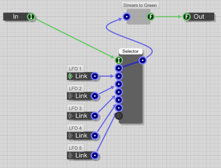

I have a problem in my current project where some of the knobs reset after a project is saved and reloaded. I know why it's doing this but I'm asking for any ideas how I might be able to work around it.
Here's what's going on. My knobs have a function where they can have their values set via an external input. Most knobs in this project can be linked to an LFO via this module:
The topmost value of the selector is empty; that's the "no LFO" setting.

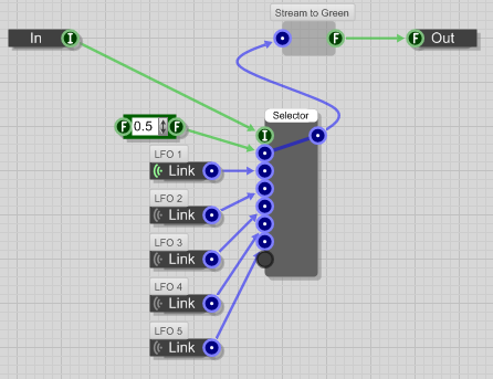

Now, some of my knobs are bipolar, meaning their default value is at 0.5. Those knobs use this:
Notice the value at the top connector. That's so that the "no LFO" setting resets it to the proper default setting rather than full left.
So what seems to be happening is that when the project is loaded, that 0.5 value is being sent to the knob, defaulting it, whereas when nothing is connected there, the knobs stay set to their previous values.
I haven't a clue how to work around this right now so if anyone has any ideas please let me know. :) Thanks.

send a trigger (with boolt to trigger) if selector is set to no lfo to a sample and hold with the value 0.5 into a last primitive before the set-in of the knob, like this 0.5 is only triggered when you set the lfo to off, else it is always the last setting value
if i understood your problem right

you also could get rid of the s&h and feed a fix value into the last and trigger it when needed, the best place for external setting knobvalues is in the presetmanager before the preset parameter prim so also the output is updated (and not only the knob drawing) , here is an example look for the "external value settings" module inside the preset module

Nubeat7 wrote:you also could get rid of the s&h and feed a fix value into the last and trigger it when needed
Yes that works fine as well. Thank you very much. I wish you had showed up before I spent that entire day pulling my hair out over this though. :P I swore I had tried everything.
