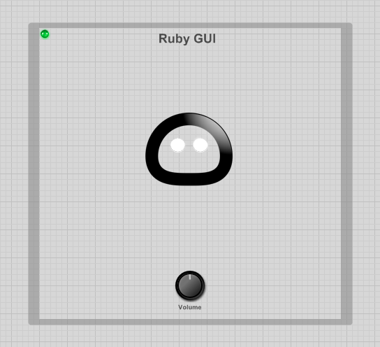

Here's an example of how to make a Ruby GUI in FlowStone in less than 5 minutes.
We have also made three short videos to help you:
Part1:http://www.youtube.com/watch?v=6-dEPTAyr_k
Part2:http://www.youtube.com/watch?v=9nrUXx9eWKo
Part3:http://www.youtube.com/watch?v=8j-jMKobTvE
Here are the source files:
